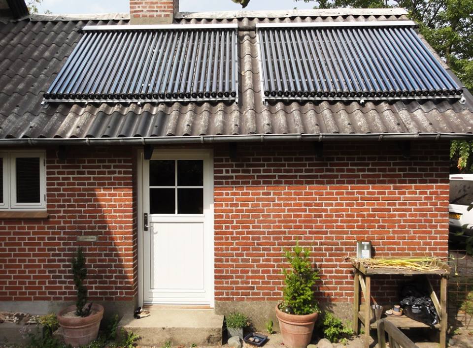

Hello
I live in Denmark and I just wanted to show you guys my new energy-system, since it is a Swedish product.
We completed the installation in July last year (2013). Solar heating and surplus energy from the solar cells takes care of our heating needs from mid April to mid October.
We use approx. 4 tons of pellets per year which is slightly dissapointing as we used 2000l oil on a 50 year old boiler previously. So I am considering adding more advanced heat control to the ever circulating system.
Due to space constraints our buffertank is only 300l which is too small to effectively reduce the number of starts on the Viking 20 burner. The burner is set at 17kw (with reduced feeding amount) and I am considering lowering it to 12-13kw to see if the consumption levels improves.
60 H-rør.jpg (137.34 KiB) Visad 14171 gånger

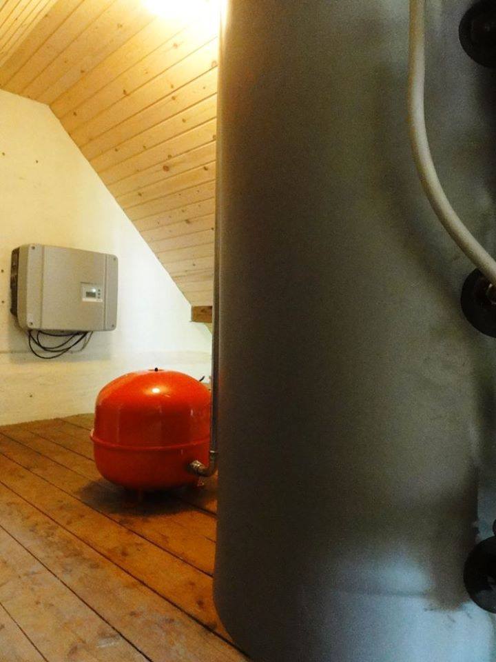

the attic w. the buffer and the inverter.
akkutank og kostal piko inverter.jpg (62.4 KiB) Visad 14106 gånger

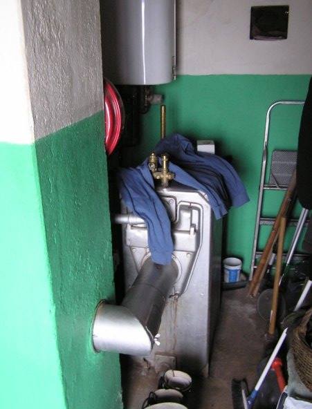

and what we used to have in the boiler room

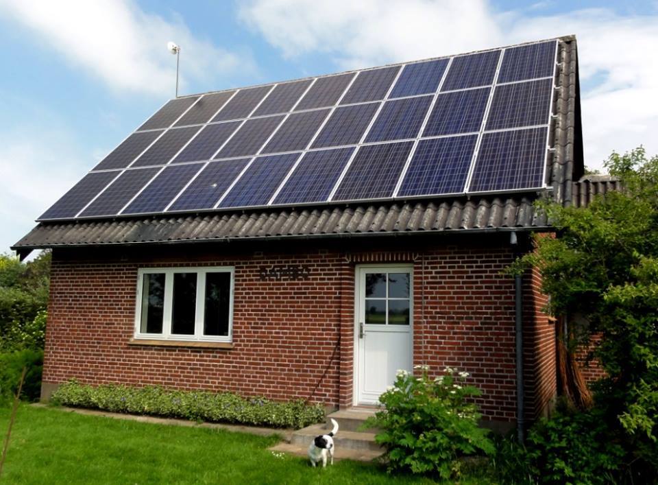

The combination between solarenergy and pelletheating really works well - here after two years of practical experience I am surprised at how easy the transition has been from an old oil-boiler to biofuels. Sure there is more work with the pellets but solarheating keeps that in check - in reality I have almost no work with the boiler from 1/3 to 1/12 (save from keeping the hopper full). In the winter time cleaning takes up a bit more effort and time - but it still is quite manageable. From 15/10 to 15/4 I used 3045kg - now it is solarenergy and electricity (solarpanel surplus) that meets our energy needs until 15/10.
I imagine that the combination of a heatpump (with solarcells) and a pelletboiler would make things even easier and still cheap in use (although not in acquisition).
With regard to solar heating I suspect that sending the solar-energy first in the centralheating system and only drawing energy for hot water when you need via an external heat exchanger increases overall yearly efficiency. This however is just a hunch - I have no solid proof of this.
